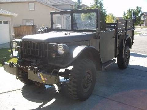

Nothing wrong with a "field-painted" look; that way you don't have to worry about scratched paint....
- Summertime M37.jpg (35.37 KiB) Viewed 3404 times
