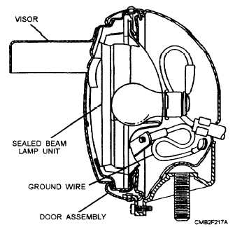

Also, Carter (long time no see!) by "doors" you mean what an old truckdriver would call the lens?
All I remember is "somebody" said "ohm" and wiring? My rememberer ain't as good as it used to could. :?

Drilling a small hole in the bottom of the housing usually won't hurt anything. Make sure it is small enough that bugs won't get in and big enough that surface tension won't defeat the purpose. If the hole is in the bottom of the housing, and it is sealed otherwise, fording operations won't allow much ingress of water.
Re: Moisture In The Sealed Lamps?
It has been a while Tim, glad to hear from you.
In the drawing the door is numbered 5 and in the second shot the part number is listed
