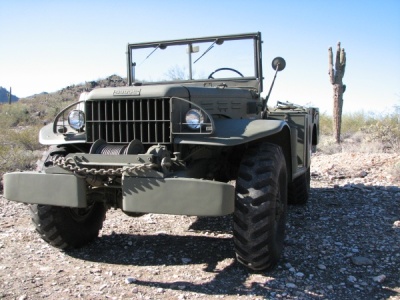

here is some on a WC
http://www.stausaonline.com/tires/sta-ndcc/ I think they made a mistake calling it a D/8 ply tire. the weight rating at 3865 suggests its really a 10 ply or E rated.
- WC52 wtih 10.50s.JPG (66.93 KiB) Viewed 2135 times
