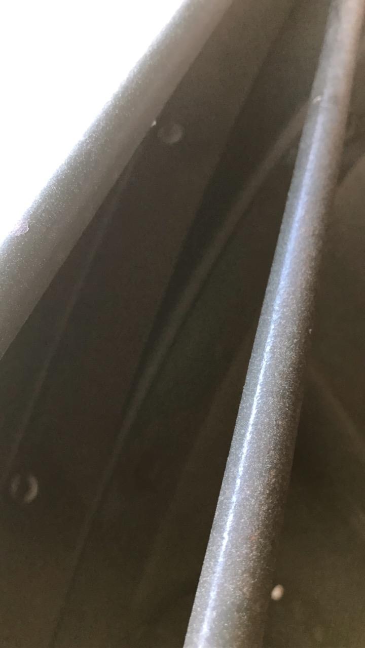

I was wondering what the other side of the button will look like? I was wrong about my rivets, they are steel and the washer is as well.
The pic is not as clear as I thought it would be?Bruce,
Re: "filler placement on side panels
Hi M-bruce. Just to clarify, in my picture above, I then pushed the plastic pin in all the way, and the little nibs on the shank do snug up nicely to the inner metal panel. I doubt I will ever take my rubber filler off again, but it would be very easy to just snip off the shank, and pull it out. Being plastic, it won't encourage any corrosion, either. i have just painted the panels with several coats of primer, and two of Gillespie paint. Look nice. By the way, for those contemplating replacing their filler, I can't recall which vender I ordered it from (I have ordered so much I can't keep track of it all), but you get precisely enough to do your truck, and not an inch extra. So if you want to cut off a bit and test fit it, don't cut much off of it!!!
