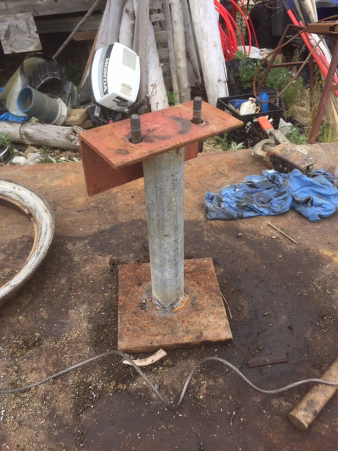

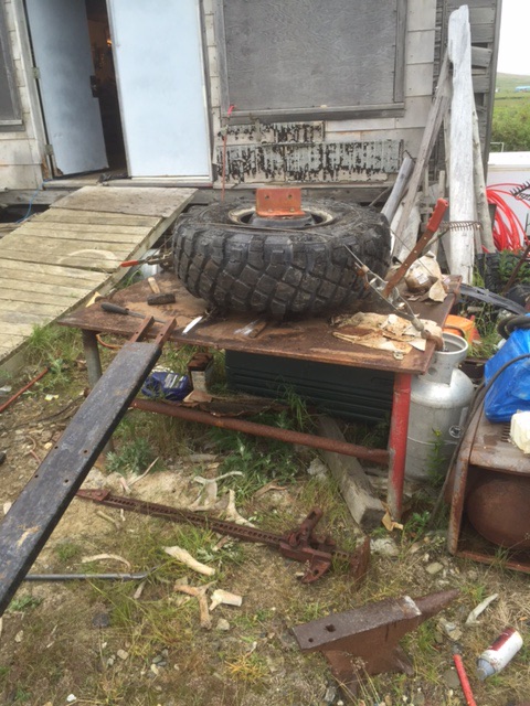

Here I am fixing my booboo. I had to slot the flaps to get the valve stems to line up, cause I couldn't find tubes with centered stems that were big enough for my tires. (I'm absolutely open to suggestions if anyone has an idea if where to look.)
I didn't use enough rubber around the valve stem so the tube is trying to herniate through the slot in the rim. The new flaps I ordered from Lucas were about 2" narrower than the flaps that were already installed, so I used the old flaps which were still in good shape. I'm using the new flaps to cut a section out of to go around the valve stem and keep the tube protected from the slot in the rim.
I put a come-along top and bottom to pull the tire back out of the way so I can get the ring on and off. I also built a work table out of scraps in the yard, which does the same thing, and makes tire changing fairly easy.
*edited because photos were rotated*

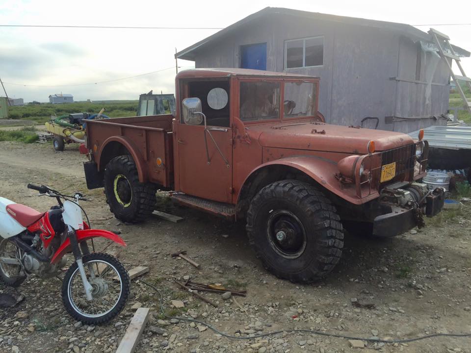

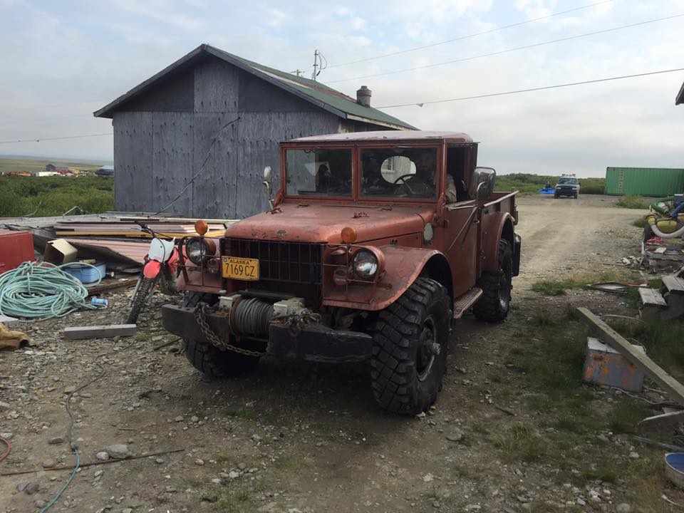

got them done and i'm super happy with them. as far as i'm concerned these are the perfect tires for this truck. they only rub at full lock to the right, and even then it's not bad, but you can hear it. they hit the lower steering control arm, just behind the grease zerk. the ride is very comfortable at 20PSI and they don't look under-inflated. i also feel comfortable traveling without a spare and just bringing spare tubes and tire irons. i can have the tire off and back on in about 20 minutes.
- 13557728_1175773365814346_3470923908642528595_n.jpg (85.3 KiB) Viewed 2708 times
- 13567013_1175773355814347_3406431349576495547_n.jpg (84.37 KiB) Viewed 2708 times

Thanks! They were a pain in the arse to find and ship, an even bigger pain to install, and then more work on top of that to install them "right" since I couldn't find tubes in the right size with the correct bent metal stems.
But now that I have them on I love them! Won't even consider anything else next time unless I absolutely can't find another set of these. They look like they belong on the truck and I don't think I could run anything bigger without modifications.
They do rub the lower steering control arm at full lock to the right but I'm not worried about it.
