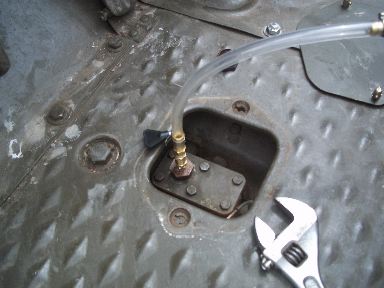

I have a newer replacement master cylinder on my truck, and I think the top was vented. I screwed an adaptor into that vent fitting hole and used my Motive power bleeder. It worked really well. I have about 5' of tubing on the fittings so I can have the power bleeder in the cab and have it reach the footboard location of the master cylinder
Posts: 4354
Re: Brake Bleeder Adapter
Ditto-I fabbed up a fitting to an old MC plug:
MC bleeder adapter.JPG (20.64 KiB) Viewed 1319 times

Thanks for the replies guys!
I was hoping that there might be an adapter with the same pipe thread somebody stumbled across.
I will see what I can rig up along the lines of the photograph below.
-T

i have fabricated an adapter using a pipe thread adapter. I think it is 3/4" with a 1/4" hole then a 1/4" hose barb.
Rick

rickv100 wrote:i have fabricated an adapter using a pipe thread adapter. I think it is 3/4" with a 1/4" hole then a 1/4" hose barb.
Rick
Exactly what I needed! Thanks!
