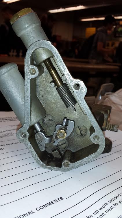

Hi, I am a high school auto shop teacher and my school owns a 1952 M37 that I convinced them to buy for the shop. It was a true basket case 1 1/2 years ago but now we are at the point where we are trying to start it for the first time since we rebuilt the motor. My problem is I had students take the carb and governor apart and I did not see them while they were doing it.
The main issue is the governor. The small chain was broken and I do not know how all the parts fit back inside. Does anyone have a picture of the inside of the governor assembly so we can try and fit back together and maybe make a new chain. I am not quite sure how the whole thing works with the chain and the small vacuum chamber plunger rod and such.

thanks for the info. Here is a pic of the governor unit I have. I will add pic of the truck soon.

Perfect thank you. now i have to figure out how the whole thing works. Does vacuum open the throttle plate and the linkage push it closed? Hence it would be in balance so to speak when running?
