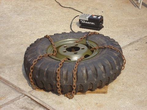

ZG. Below is a picture of how I mounted one of my tires. I used a chain and small compressor as you can see. The compressor aired up the tire slowly and gave the tire bead time to seat against the lock ring and rim. The opening of the lock ring should be on the opposite side of the tire across from the air valve. I did 8 tires this way and didn't have any problems, Hope this helps.

Thanks Sal. I was going to use chains and I have a lock on chuck with a long hose to a manual controller. I just have never had a vehicle with these rims before and I have never changed a tire on one. I need to buy another Premium Traction tire, tube and flap to put on a rim as a spare.

The tire shop told me:
1: ALWAYS use an air fitting which locks onto the valve stem, so you're not close to the tire
2: ALWAYS use chains (as shown) or a cage
and
3: Air the tire up to 25-30 pounds, deflate, then air up fully...this allows you to check if the lock ring is seating correctly.
This being said, I have never done a mounting on these rims myself...BE careful!
