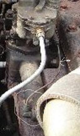

Usually when you have to use the choke to make it run without stalling it mean there is a vacuum leak somewhere. I had one that drove me nuts for a while . I found that the priming tube on the intake manifold were the cause. I removed them and used pipe plugs to close the openings. I found it by using a vacuum gauge and a can of Carb. cleaner.

Where is the priming tube. Is it under the intake manifold?

I should have said manual primer lines instead of tube. There are fittings in the side of the intake manifold as you face the side of motor with thin lines attached to them. See picture below. That's where I found my vacuum leak
