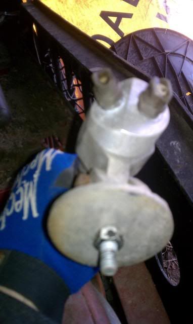

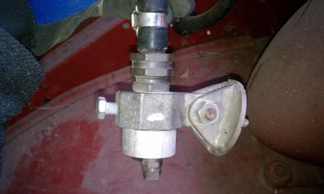

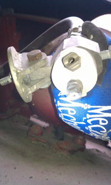

Been trying to figure out what the heck these things are on the truck. One on each side and the piping seems to run back through the firewall but I don't know to where exactly.
They look like some sort of spray nozzle. Judging by the size of them, maybe fire fighting foam. Maybe at one time there were valves mounted in the cab. It looks like your truck may have been one bad a$$ brush truck at some time. It seems most of them (mine included) were hack jobs at best. I wouldn't call you crazy if you wanted to restore it as a fire truck.

those are sprayers. they are typically mounted to spray just in front and to the side of the tires. They work great when fighting fast moving fires in short grass. there may have been flip switches in the cab to activate them or at least the more modern ones. Those look more of a homemade job but at least they used bands on the hoses instead of worn gear style clamps. (radiator hose clamps)
