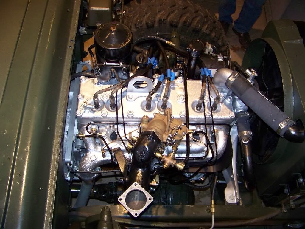

The cooling lines run from each side of the distributor across the block to the elbow connects to your carbureatour. It forces air thorugh the lines to cool the distributor so your thermostat can be eliminated as a possible cause.

You may want to check the air horn between the air filter and the carb. I've got one that is missing the angled tube and the bent tube that go into the airstream inside the air horn. IE look inside the tube where the lines connect to the air horn.
I burnt up a couple coils with that one.

The line size is 3/16", the fittings are special to the application, you will have to find originals or make them if yours are missing.amanco wrote:My cooling lines are gone. Haven't been there since I have had the truck. Some one at some point in time decided they were not needed.
I want to put them back. What size line and in the previous message what angled tube should I be looking for? One inside the air tube between the air cleaner and carb? Any photos?
Ours were trashed, so we went to NAPA and bought a fist full of various length brake lines and BTF (bent-to-fit) following the ones that came off. We replaced all the fittings from ACE Hardware. We ended up using a small piece of copper tube and soldered it into place pointing up stream. We spent about $25 and it all new.
