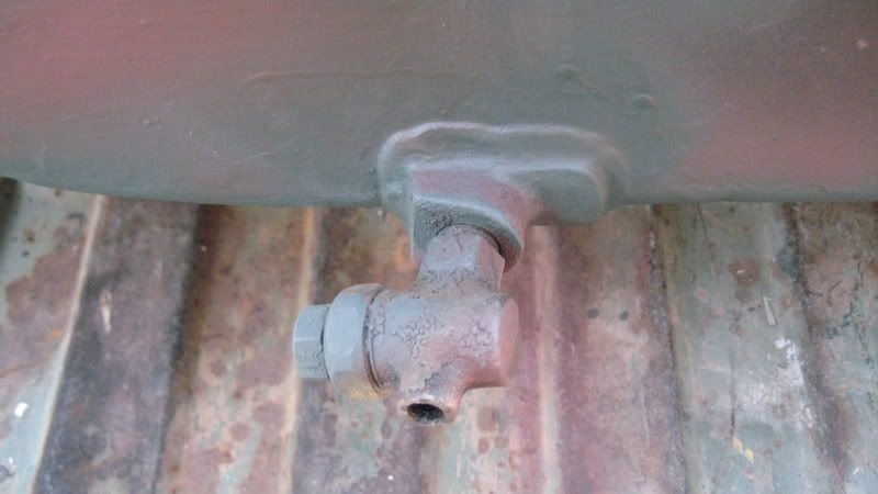

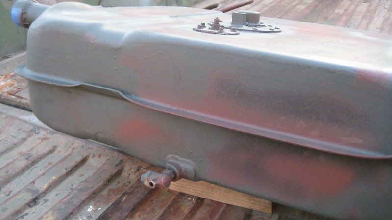

And it should be brass, does it have a plug or just a nipple?
This tank is out of my 1952 truck and has an orig. drain valve. I believe the tank is earlier than the truck as it's serial no. is 80259056, and they were deleated after serial no. 80042080. If yours looks like this one you may have an early tank.
