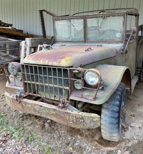

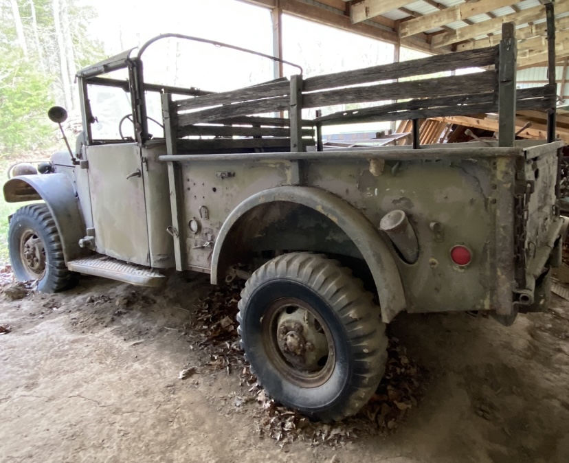

I’m beginning a project my dad and bought about 30 years ago. It’s an M37 with a seized engine and needing some serious love. When we couldn’t get it turning back when we bought it, life happened and it sat untouched for 3 decades. Now I’m ready to bring life back to it and I’m preparing to bring it to my house.
I’m going to find the rest of the numbers to add it to the registry.

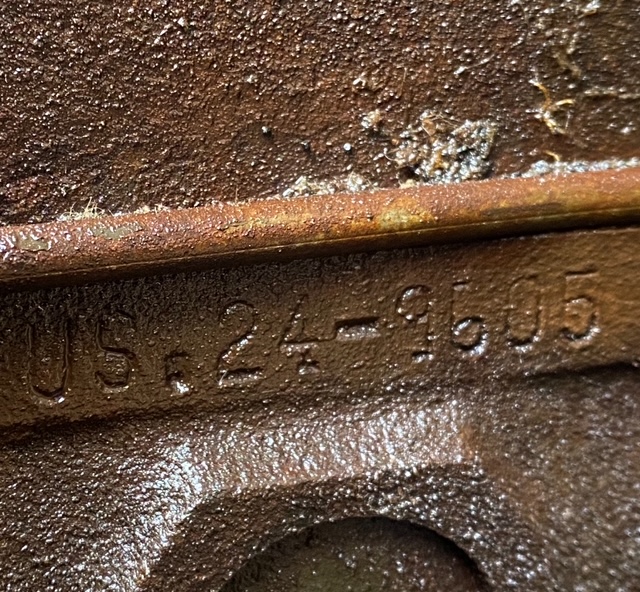

Anyone recognize this engine code: US.24-9605. I’m curious if it’s the original 230 flathead?I’m going to find the rest of the numbers to add it to the registry.

Thanks for checking in and posting. Looks like you have a nice straight truck. It appears that you've kept it under cover.

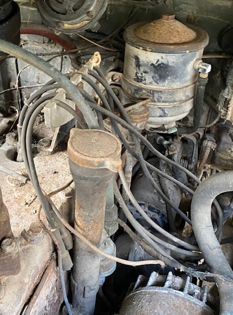

That block number is different than the usual T245 engine. Does it have the waterproof oil filler and dipstick? Those were unique features of the G741 series engines.

Regarding whether the motor has the waterproof oil fill tube and dipstick - it looks like it does to me. Here’s a pic

Except for the spark plugs, cables, and cable clamp, the photo shows what appears to be an original installation.
