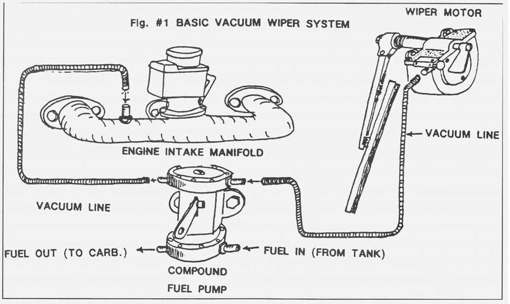

Hello again. I am installing the vacuum wiper system and putting the folberth motors. does anyone have a diagram of how the lines are routed and how the system works?
Thank you in advance.

Hi. I have the same motors, but as I need to rebuild almost the whole windshield due to rust I haven't installed them yet.
The attached image is simple but helpful.
Sebastian
Sebastian
- Vacuum wiper lines
- fileE53U42KF.jpg (80.73 KiB) Viewed 695 times

Thank you Sebastian. Great help!
Where is the control valve located for the folberth motors? mine does not seem to have a on/off switch like the ones on the diagram. I have those motors on my M38 but the folberth motors are different and I am not familiar with how they work, turn on, etc.
