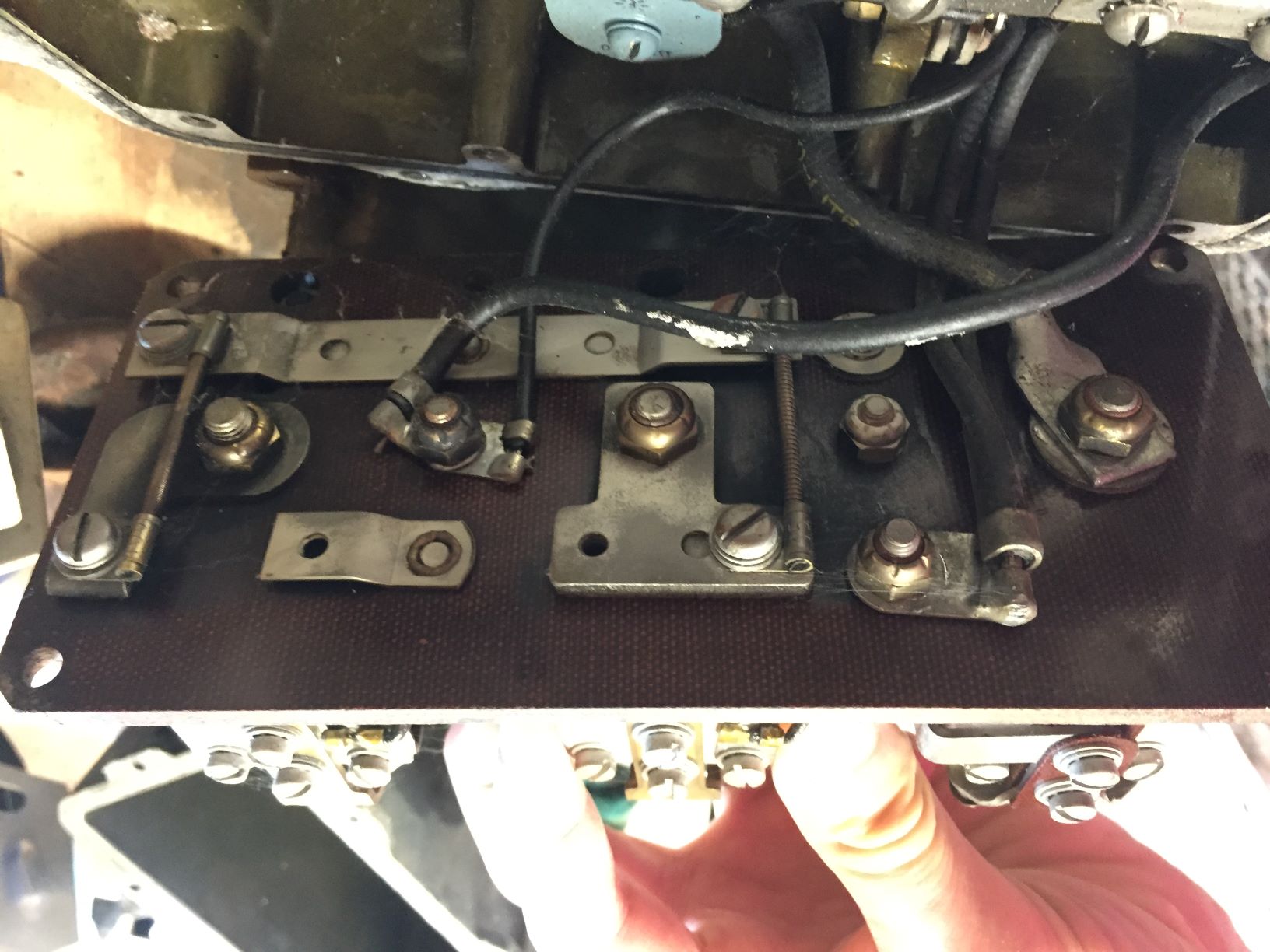

I have a question regarding the internat resistor called R3 inside de regulator.
mine is a 25A regulator and found a melt resistor that also seems to be incorrectly connected.
I will upload some pictures but the connection is different from what I have in my TM. Also it turned to be that it wasn't blown and the resistance is 97ohms not 174. will have to check in another TM. this is for a Canadian version but this should be universal I think.

Hello!
I correct myself,
So R3 is missing, R1 is 400 ohms instead of 174
What I have overheated is R4 that goes to ground
Can you tell me the correct TM that I should see?

What I suspect:
- polarization was gone
- water/ humidity entered and needs to be cleaned
- main ground was poor due to rust between housing and chassis
Actions:
- replace overheated R4 (see picture there is a smoked flame in the board) with the same 100 ohms specs (will ask supplier for the power rating)
- clean contacts and rust to warrant good conductivity
- take pictures and test :D
At the same time I will disassemble the generator to inspect too. Will also try to polarize it if I can.

ouch!
it only has 2 resistors :cry: and it is prepared to hold the R3 better than mine.
hey thank you so much for taking your time!! the TM is very good also.
will try to just restore it as it was.
just to clarify this M37 is not Canadian. I just have a Canadian TM hehe.
But the Canadian TM seems to be pretty close.
I am suspecting that this regulator belongs to another vehicle. I have found it in tanks... but still no TMs.
I feel that by restoring it back like reverse engineering it will work.

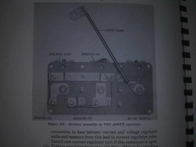

Posts: 1246
Re: generator regulator
I have nothing on 4003. But VBC-4002UT is covered in TM-9-1825B
R1=200. 190-210
R2=15 14-17.1
R3=175 166.25-183.75

Post by vit16 »
thank you guys! that is the same what I have in the Canadian TM. No Diagonal R4 installed to ground.
