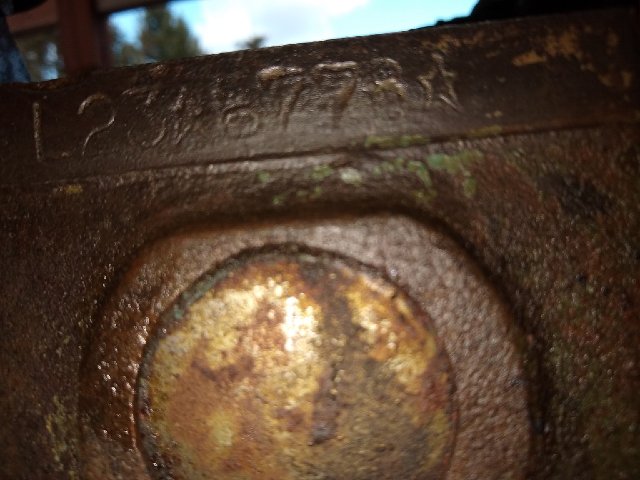

So I'm new to the site but I just picked up an 1953 M37 from an estate sale, it was the last of the collection so as you can image its pretty rough but the price was right. I'm not sure how to post pictures yet but when I do I'll get some up. Got it dropped off and have been taking it apart because it will need a bunch of work, still trying to decide on the direction i'll be going to get it fixed up. Currently the motor is seized, thought its not the original motor as far as I can tell, the block starts with L23 and from what I looked up that means it was built in 1958. It has an artic hard top from what I can tell and a pretty nice bed thats just floating on the back right now. I'll probably have a ton of questions but I'm excited to get to work on this.
