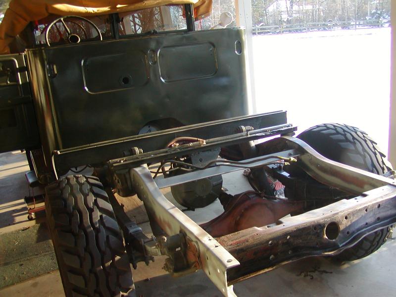

Right now I have 16 inch HUMVEE tires on my stock wheels, shopping around for their replacement. They've been mounted for almost 20 years.
Before Paint.jpg (69.58 KiB) Viewed 3054 times

m-37Bruce wrote:Right now I have 16 inch HUMVEE tires on my stock wheels, shopping around for their replacement. They've been mounted for almost 20 years.
20 years ago that should have been 16.5's, you might want to look at the side wall for the size and if they are 16.5 be very, VERY careful!!

Rick, They have been mounted since 97, no matter , either way, they are going away soon as my combat rims will get new rubber.
