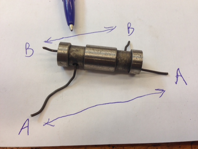

Wondering if anyone has seen one of these. It's what was in our spare motor and is not the usual relief valve.
The lettered portions are attached and there is a chamfer on the side that the pen is pointing to.
Oil Pressure Relief Valve.jpg (67.22 KiB) Viewed 2088 times
I did find some info on a valve that looks like this variety, but I have not seen one in the T245's I've seen.

The ones I've seen so far look like what's shown in the manuals. This one is different, maybe it's for a passenger car???? I'll have to post a diagram I found when I get home. I suspect it works OK as the engine bearings looked OK, it's just not what I'm familiar with. On the bright side, I don't think you can put it in backwards!
Posts: 848
Re: Oil Pressure Relief Valve - This one is different???
Did some digging and this may be from a full flow filtering system. Not sure how it ended up in this engine, but I guess I'm not surprised! This thing's been around the block a few times.

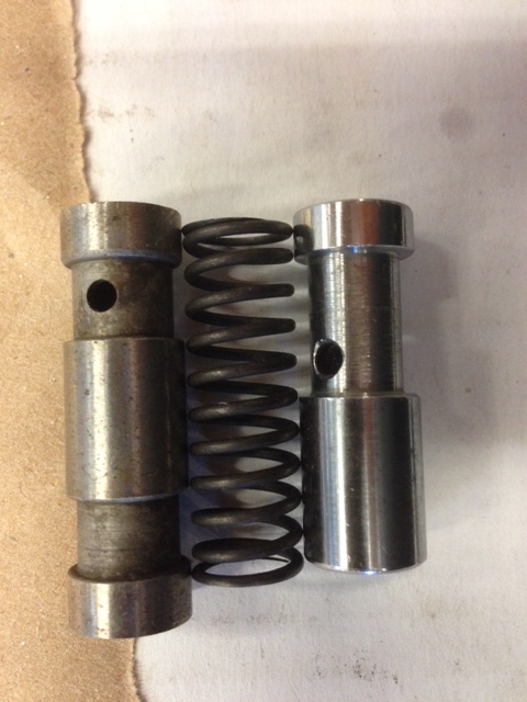

Picked up a standard valve and new spring. Here's a comparison:
The old spring and new spring were essentially identical. The new one was a "green" spring which is supposed to be the "heavy" one. The valve on the right is the standard valve.
Pressure Relief Assy..jpg (103.08 KiB) Viewed 1971 times
Wonder what was going on with the oil pressure in the motor we used as a core. Yikes!
The one on the left matches mine. Is the one on the right for a full flow engine?
Posts: 848
just me,
The one on the right is the standard valve. I think the one on the left was for a full flow engine. Of the 3 engines I've played with the one on the right is what I've seen in 2 of them. The one on the left was in the core we're rebuilding, but I'm swapping it out for the standard valve.
