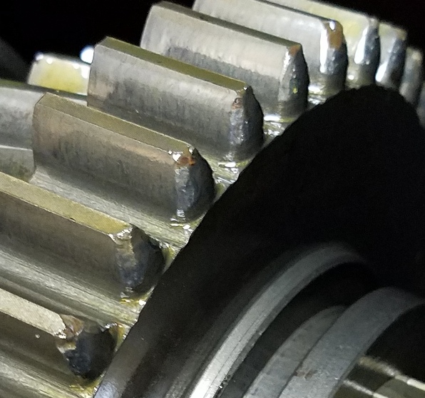

Any chance of finding a decent replacement 1st/2nd gear for a NP420? If so where please. Removed the NP420 from my 46 years static M37. But before that I drained the oil. To my surprise it came out looking fantastic...then we got to the bottom where the stream turned to light brown syrupy ick. So out it comes. Removed the top of the case to have a look see. Found the 1st/2nd gear to be a bit rough, the edges of the individual teeth which lead the engagement with the reverse gear are chewed up. Here is a pic. If I cant find a replacement perhaps a bit of hand stoning to remove the sharp edges is advisable. Desperate I realize as I think I am through the case hardening on some of the edges. Sigh.

Found! AB Linn is out as are the folks at MidWest Military, but Paul at Surplus City came through!
