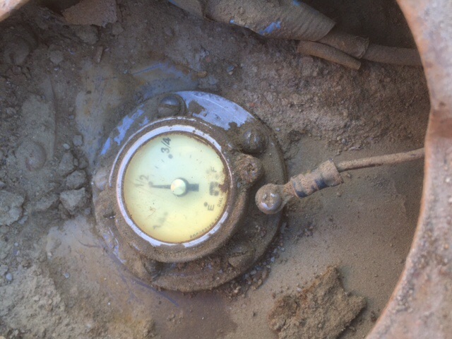

Fuel gauge stays pegged at full, i pulled the cover off in the bed and took a look, there is one wire connected to the sender which goes to the frame, and another wire that probably used to go to the sender which is taped over. I'm not sure why it was disconnected or where it reconnects to. Is this even the sender that's supposed to be installed?

That is not a 'sender'. That is the fuel guage. To keep from damaging your guage, ground the sender wire. It will go to empty on the guage.
My experience with the sender's sold by the MV suppliers is that they are junk. They do not have long enough arms for the float to touch the top and bottom of the tank. The floats are junk and sink in a year. I used a fully adjustable aftermarket sender and am much happier. It is the same ohm as pre 64 GM. 0=empty and 30=Full.

Well...........I have to admit..........I've never seen "that" before. If you have an original M37 fuel tank there are two holes in the top of the tank, a big hole and a smaller hole. The sender goes in the smaller hole, the pickup tube and vent line attach to a plate that goes in the larger hole. It looks like what you have there is a fuel gauge that someone mounted into the top of a sending unit........or some kind of composite gauge/sender from something else. The M37 sender has a single Douglas connector that connects to the wiring harness, or a single Packard connector for the later B1's, and is grounded by being in contact with the fuel tank (which is grounded to the frame). It's basically a variable resistor that changes resistance as the float moves up and down, which in turn changes the voltage which is read by the fuel gauge in the dash (which is acting like a voltmeter).
I have to agree with Just....the repop senders are junk, from what I've seen. What you can do is get a good used sender from an M38 or M38A1 (depending on which type of connector you need) and modify it by lengthening the part that sits in the tank. That will give the arm that holds the float enough "swing" to go from the bottom of the tank to the top. The other option is to get an older original brass float and use it with a new repop sender.

What you have is a tank from a 3/4 ton generator trailer. The tanks are almost the same size and the only other differences are the gauge you have on top of your tank and it lacking two holes for the sender and for the fuel pick-up. Had one like yours once but sold it.
