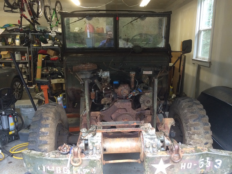

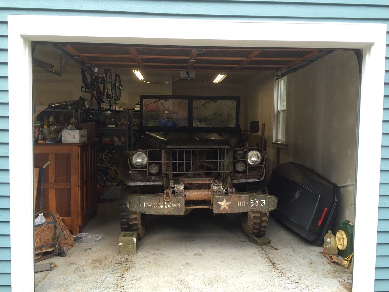

In the garage working on the tear down.
- Front sheet metal off
- IMG_2926-800x600.jpg (203.76 KiB) Viewed 4197 times
- In the garage
- IMG_2843-800x600.jpg (155.47 KiB) Viewed 4197 times

The truck looks to be fairly complete.

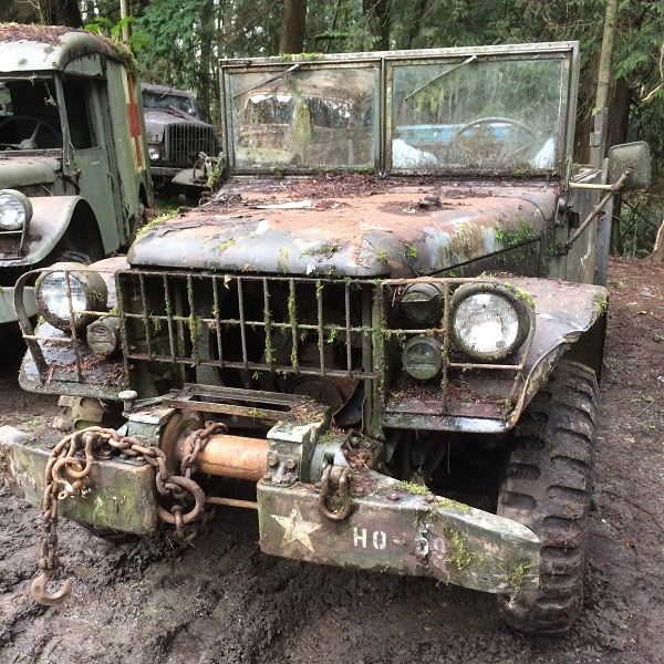

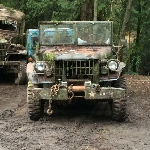

wow I love the first pic id like to see more like that

Looks like your truck was growing!
That first set of photos is pretty wild. I look forward to more, with less lichen and moss of course
