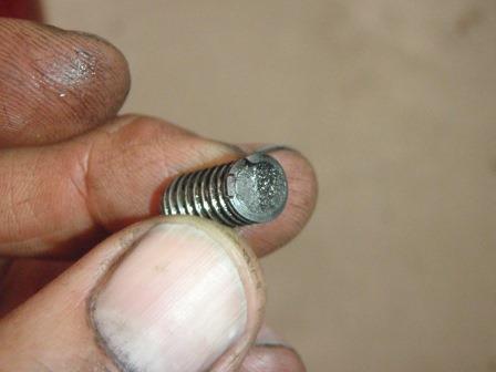

For 5 weeks now we have had all hands in the Auto Shop working on a MVCC buddies M37. What seemed to be a relatively quick and fun project turned into a fun and rather substantial rehab. The truck looked great, but underneath lurked many years of poor maintenance and hammer mechanics. It's been a great teaching tool due to all the "adventures" it has offered us. We were preparing to wrap things up and were changing the oil prior to some good-bye dyno pulls and SURPRISE!
The remainder of the bolt is 5/16-18 and was hit repeatedly on one end before breaking. There are beach marks visible and it is slightly bent. I'm trying to figure out where it came from. My current thoughts center on the last knuckle head who worked on the truck. They replaced the fuel pump and it only has one of the stock bolts now. I'm wondering if they put in a bolt that was too long and it impacted the crank a few times before failure. I can't think of any other 5/16-18 in there hardware, can you?

New Game! Name that chunk of 5/16-18 hardware!
