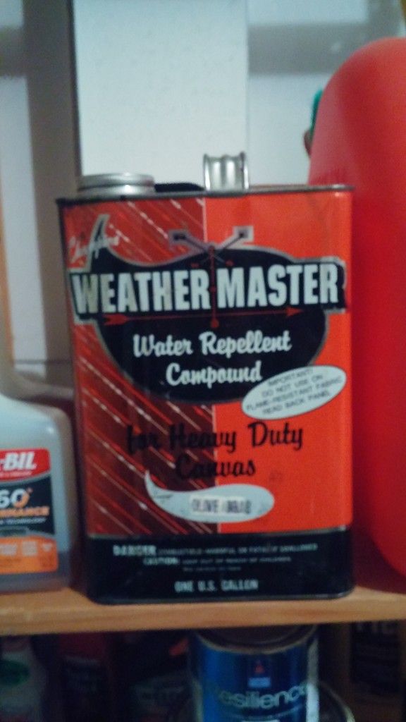

I used this on a top in the same condition and it worked. It takes a half gallon with a brush to do a M37 top, and two coats, be liberal with it each coat, brush In the same direction.
Before and after on a top I sold and a pic of the can. If you cant find it I can send the half a can I have left. Its green in color, can says Olive Drab.

Re: OD Canvas
carolinamv,
Where can you get the can of Weather Master you have pictured? Who makes it? And most important, does it have the sweet aroma of military canvas once it's applied?
Also, can you provide a better picture of the can?
Thanks
Kevin
