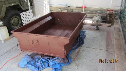

ZG. Which ever gun you buy make sure it matched the CFM of your compressor. The CFM rating should be on the data plate of the compressor and on the gun. To give you some idea my compressor is rated at 8.6 cfm @40 psi and 6.4 cfm @ 90 psi . The 2 guns I use are Harbor Freight and there rated at 6 cfm @ 40 psi and 3 cfm @50 psi. I know HF stuff is Cheesy but I found they work for me with Gellespie paints. I did my truck and a 101 with them and I'm doing a 416 trailer now with the same type of guns. I also use a disposable filter on the air line of the gun, that keeps out water and any oil that come from the compressor.
