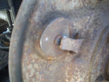

Some might recall my brake overhaul posts from 2014; yesterday, with 500 miles on the overhaul I decided it was time to tweak the D-ring adjustments on each backing plate at the 10 and 2 positions. This was relatively uneventful until I got the wrench on the left-front, front adjuster which just flopped around loosely. Most likely the weld holding the D-Ring broke loose, so I'll pull that hub today and examine/ repair.

:shock: That's not good Gary, let us know what you find when you open it up.............maybe a picture of the failure would be nice. :wink:

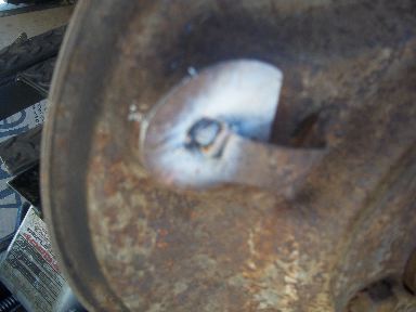

Thanks guys-indeed the D-Ring is detached from the stud. I did a temp fix, tacking it back in place and will be looking for a repair kit in Topeka next week.
Oh yeah, Bert, pictures... :)
