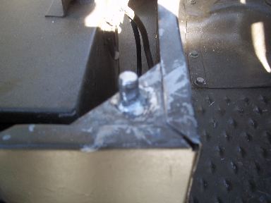

Does anyone have a close up of the peg that locates the front corners of the passenger seat? I've recently discovered it's pretty important! If I have a decent photo I should be able to make a replacement. Thanks!

Hi Andy,
Sure do-scroll away:
http://www.g741.org/PHPBB/viewtopic.php?f=3&t=6719

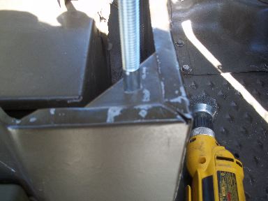

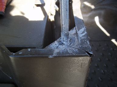

P.S.-I've since added a 2nd peg to mine for extra stability, using a long bolt, drilling through, passing it up from underneath, welding it in place then cutting off the excess. I can post those pix later today if you need them....

Sorry I didn't get back to this-still laying sod in the yard (see my other post in the Soap Box section); but yes, originally tacked on top-my addition included a full weld around the top circumference as well as tacking the underside for added strength-I'll add those photos this afternoon.

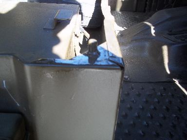

Here you go..............

OK, here are my pix:
apply some 24087-done.JPG (15.77 KiB) Viewed 2083 times
trim bolt, dress weld.JPG (14.33 KiB) Viewed 2083 times
tack bolt in place.JPG (17.42 KiB) Viewed 2083 times
insert bolt thru bottom-up.JPG (16.52 KiB) Viewed 2083 times
seat peg-drill hole.JPG (16.13 KiB) Viewed 2083 times

Photos and a complete step by step repair, what more can I ask ?! Thanks :D
