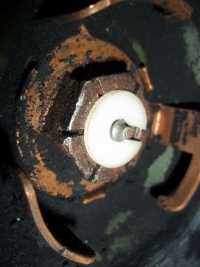

Re: Another Horn Question
All of that in the last photo is sitting too high-the lip on the metal nub should sit flush against the top of the center insert, then the insert needs to sit flush against the steering wheel nut.
I'll pull mine apart later today and post a photo.

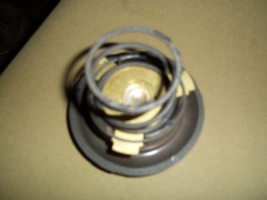

OK-this should help-let me know if I can assist further,
- horn button internals.JPG (12.4 KiB) Viewed 2339 times
- Horn wire seated.JPG (20.04 KiB) Viewed 2339 times

Re: (PIX ADDED) Another Horn Question
Mine only works when the metal nub is farther out, is that ok? or should I get a new spring and horn button?
Is your contact assembly set up like my top photo (which is why I included it)? If that's correct, you could pry the insert up a little and put an O-ring under it, then re-seat it. Try that and let us know; I don't think you need a new assembly, just some fine-tuning
No , the spring on the inside contact was backwards, I took it apart and made it like yours, I will test asap.
