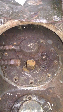

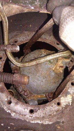

I opened up the fuel pickup plate and, to my surprise, found an old electric fuel pickup (fuel pump) inside instead of the J-shaped tube. It is caked with all kinds of crud so I have tried getting it out, but it is bigger than the pickup plate hole. Has anyone ever dealt with one of these before? Does anyone know how to get one of these out of the tank?
There is a post on the top of the pickup plate that is for a wire to power the unit, but no wire was hooked up to it. The man that I bought it from bought it from a government auction like 40 years ago and then parked it almost right away; I don't think that the unit came from him. I will try to post a picture tomorrow or so.
The fuel pump. Looks like a lead casing? The picture doesn't give the pump justice to its size.

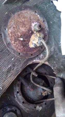

Underside of the fuel pickup plate. I broke the pickup line off trying to pull the plate up higher than one inch (not enough to see what was preventing it from coming out).
Fuel pickup plate (notice the post for the power wire)

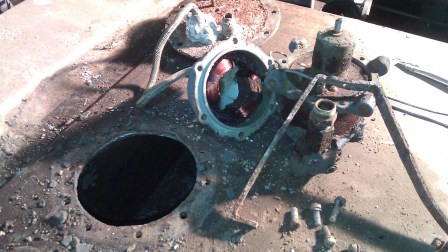

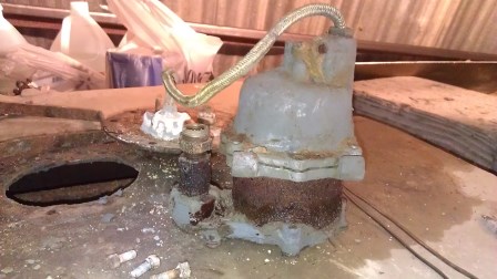

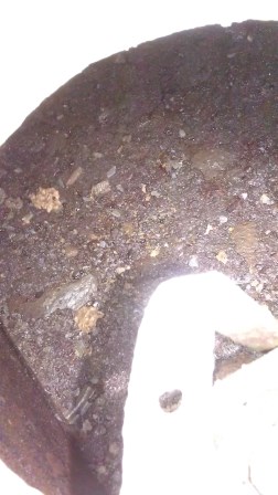

I finally got the fuel pump out of the tank. I had to drain the fuel, drop the tank, soak the pump with WD-40 for two days to loosen the rusty screws, and then disassemble the pump inside the tank in order to pull it out. The pump and bottom of the tank are coated with some kind of bluish-gray crud; I don't know if it is intentional, or if it is some kind of oxidation/other reaction that has occurred. Attached are photos of the adventure...
Rust, sediment, and crud in the tank.
Disassembled fuel pump.
Assembled fuel pump.
