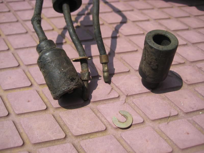

Does someone have a diagram, picture or description on how to assemble a Packard connector? The Douglas connectors are pretty much self explanatory, but I cannot figure out what purpose that little brass horseshoe looking plate serves and where it goes (looks something like an old Pakman icon). I am in the process of making an Douglas to Packard conversion wire (for my new temp gauge). Thank you!

Carter posted this picture a while back. Hope it helps..

Sure does! Thanks Sal and Carter.
Re: Packard Connector Assy
Forgot about that picture Sal, thanks for reposting it and to Jeff, you are welcome friend.
