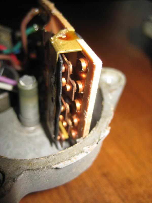

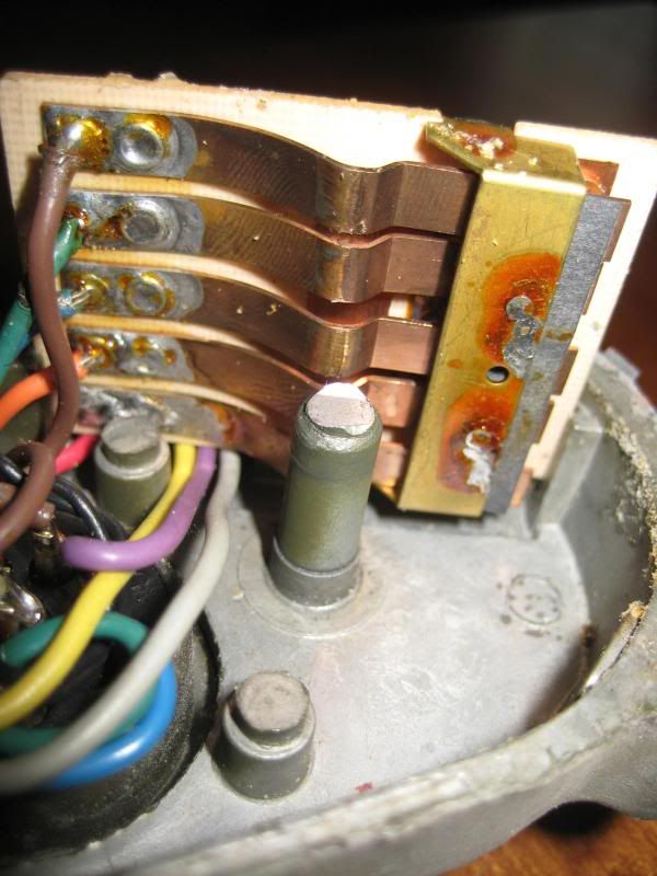

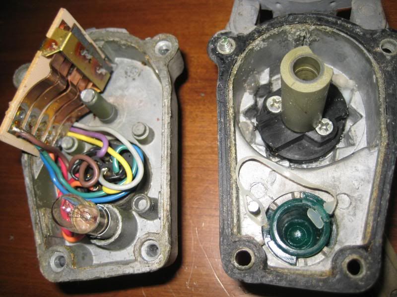

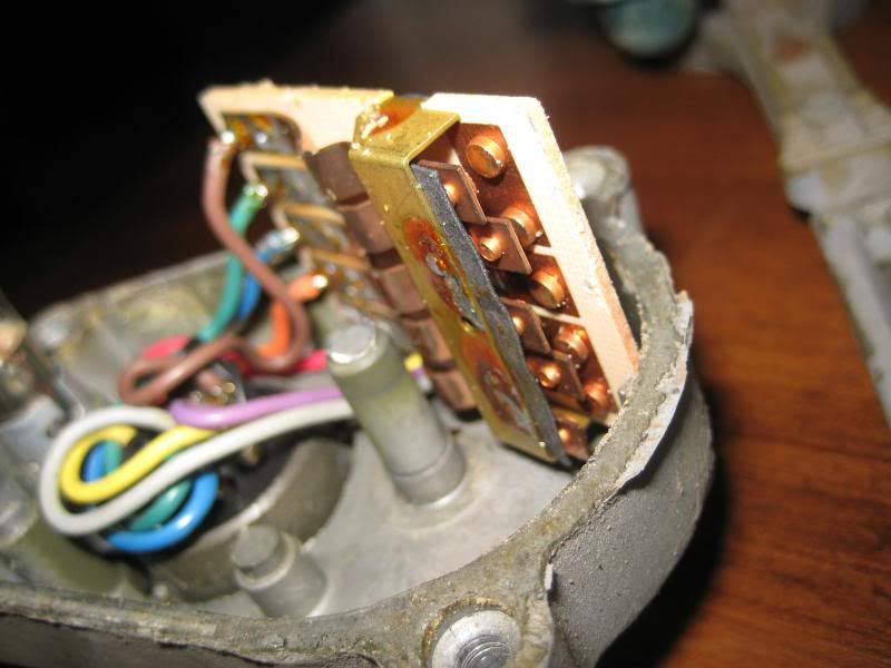

Disassemble the switch, unscrew 4 screws, halves might be stuck together so use a thin blade knife to coax them apart, nothing will jump out and get lost . Inspect and clean the contacts as you would with ignition points, remove oil film, oxides and possible corrosion on the points at the end of the fingers. You might want to clean the insides if the aluminum case as well since you have it apart, then reassemble and give it a try. I have done this with several and always had good luck bringing them back to life.

Carter, great pic's. Points me right to the possible problem.

m37jarhead wrote:Carter, great pic's. Points me right to the possible problem Jerry
Glad to help Jerry, the switch is so easy to disassemble that it only took a couple of minutes to set up and get the shots. Hope you are able to correct the problem.

This morning I did exactly what Carter recommended. Cleaned up the points, re-assembled and
now all turn signals work. As Carter said.... probably didn't take me 20 minutes for what
turned out to be a minor project. Note that the points contacts did not "look" corrorded and
they seemed slightly out of alignment. Mom's nail file did the trick on the points contacts
and I did some minor adjustment to re-align to contacts.

I am happy I was able to help solving you problem, I had the very same trouble with a NOS unit I installed on my truck and spent hours searching for a cause. I thought since the unit was new it must not be bad but after much time spent eliminating other possible areas of concern I focused my attention on the controller which, although was unused, turned out to be defective and with a thorough cleaning had a functioning turn signal system at last. After reading your orig. post I thought you may benefit from the knowledge I had gained through hours of trial and error. :D
