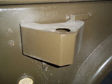

Does anyone know the correct location for the AB243/G mount on the L/S of the bed ? I have a general idea of the location , above the knockout , but does it cover the Bow strap mount ? I want to get some what close BEFORE I start drilling HOLES in my bed .

Can't say if mine is correct, but it looks good!!
The bottom of my bracket is 1" above the highest point of the tie-down cleat.

Thank you for the pictures , I just wanted to be sure before I started drilling holes in the bed . I picked up the 3 antenna sections yesterday from one of the people in the club , he has a ton of radio stuff and he is getting out of MV's . He has the whole radio truck set-up , would look good . Possiable future purchase ? thanks bob k

Both of my beds had knock-outs for the wiring but nothing for the actual AB243 bolt holes (6), so I leveled mine up against the bottom-front of the bow strap mount, leaving enough room for the strap to flip up and down properly.

Can you guys snap a picture inside of the truck bed and out when you have a chance? I picked up a mount at Iola and when I looked at the bed sides I only found the knockout for the antenna wires. Which side of the truck bed is yours mounted on? Is there loose strap steel plates mounted on the inside of the bed to make it more rigid?

Mine is on the left side. I'll have to look, but I don't think I can see everything with the armor box in, I think some of that area is behind the armor.

I mounted mine today , just below the strap mount on the left side in front of the wheel opening . You do need the 2 steel plates inside the the bed to stiffen up the mount. I made mine out of 1/4" x 1" steel . Looks like it was always there .

Sorry it's late but here you go Bert:
- AB243 outside.JPG (18.07 KiB) Viewed 2187 times
- AB243 inside.JPG (18.21 KiB) Viewed 2187 times

Thanks for posting the pictures Gary. It looks to be mounted higher than I thought. I will stare at it more this evening.
