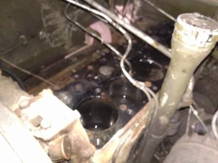

Weekend two of the restart:
I started by checking compression. Found 0psi on #2 and #5. So, thinking it would be good to get to the valve access covers, I decided to pull the intake/exhaust. That burned most of my Saturday! Should have listened to Jerry! I could verify the stuck valves from below, but couldn't get them to budge.
Since I couldn't unstick the valves from the bottom, I pulled the head. Shoulda done that first! I had a buddy tap down the valves and squirt them with PB while I spun the motor. Got the valves unstuck and the head back on before taking some pics and heading home. Next trip - new manifold gaskets, change oil, and try again.

Greeno: No, you were right to pull the valve covers. It just confirms that the valves are stuck and you'll have to pull the head, which you did.
Compression test also good before removing head. It's always a good idea to try the cheap and easy things first before diving into a mechanical
problem. Keep us posted.
