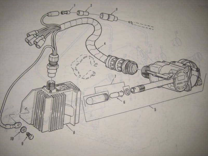

M37s did not come with turn signals but the later series trucks the M37B1s did. Early trucks were retro-fitted with them as was mine which took place when the truck went thru rebuild at Letterkenny Army Depot in 1968.
Click to enlarge:
One of the systems installed on M37B1 trucks, others look slightly different but all functuon the same. This was taken from TM 9-2320-212-34P dated April 1972

The kit illustrated above was introduced in the 70's and was often retrofitted to both M37 and m37B1. The mil kit introduced in the 60's and included on the M37B1 was the relay type kit using a firewall mounted relay box and a Signal Stat early 900 series switch on the column. The later Signal Stat switch you have is a commercial truck switch and was available in both 12 and 24 volt.
