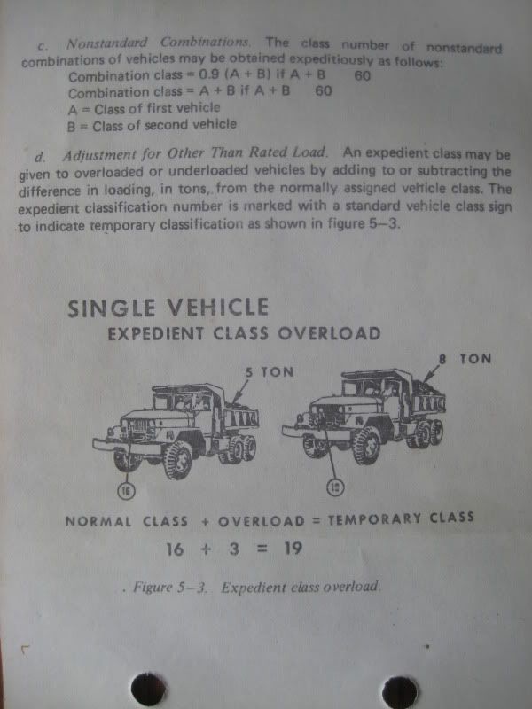

The numbers indicated on the bridge plate are the gross vehicle weight of the vehicle.
If towing a trailer the number is changed to add the gross vehicle weight of the trailer and
the plate with the "C" is exposed to mean "in combination" with the towed vehicle.
