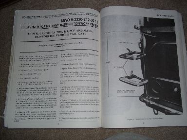

That's a Dept of the Army MWO and is listed in the Ahl restoration guide. I want to say it was dated 1967 but I can check and post the actuals this afternoon.

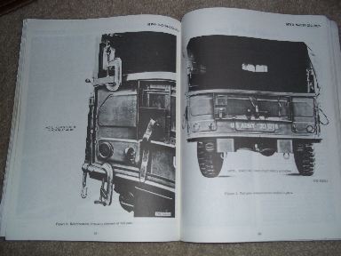

No scanner, but try this (courtesy of David Ahl):
MWO 1_1.JPG (20.9 KiB) Viewed 1506 times
MWO 2_1.JPG (18.72 KiB) Viewed 1506 times

Where did you get that publication?
hb
Posts: 4354
Re: Tail Gate question
That's in David Ahl's M37 Restoration Guide, and I purchased it from David himself some years ago for $19.99. I won't plunge into the many opinions of the guide but it's helped me out a number of times when I needed a quick answer or spec.
