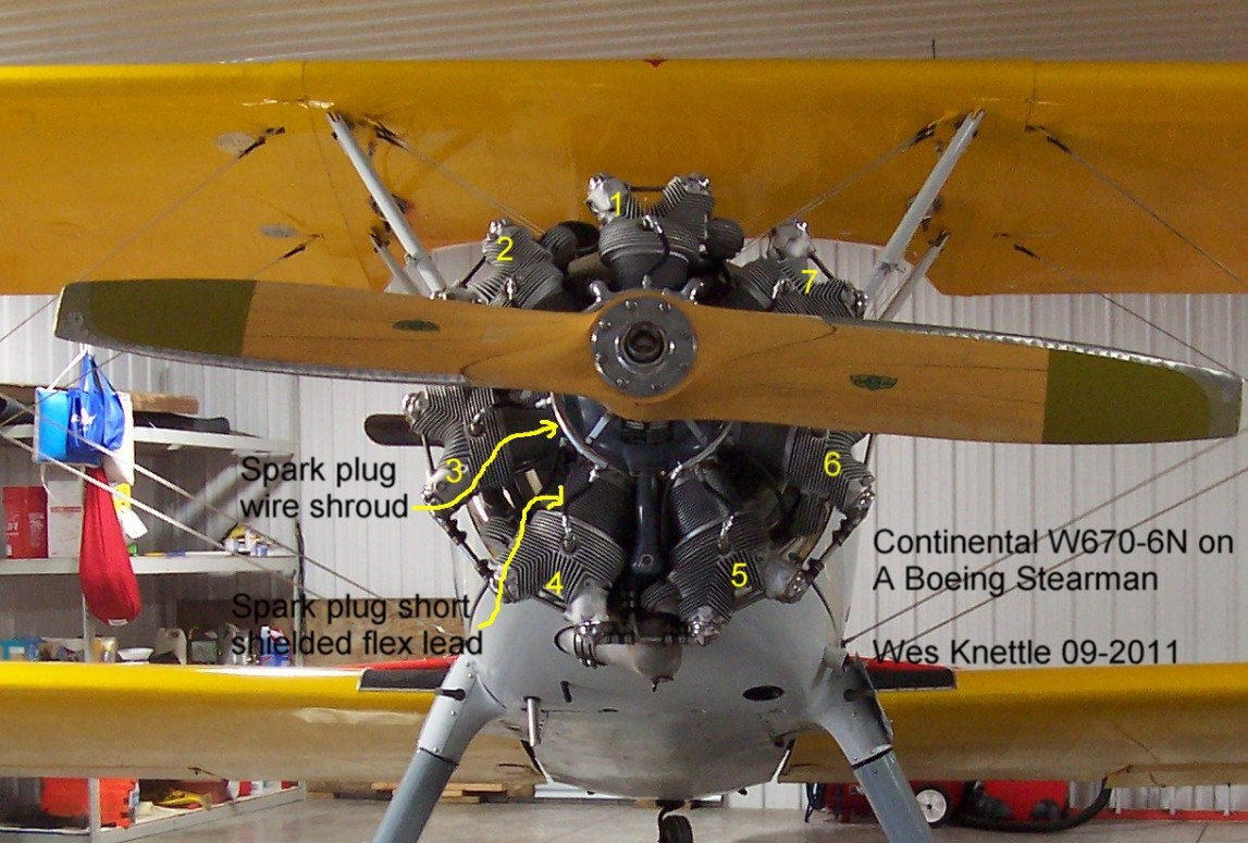

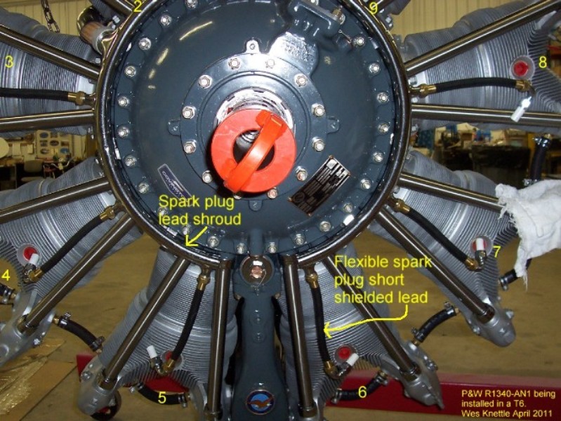

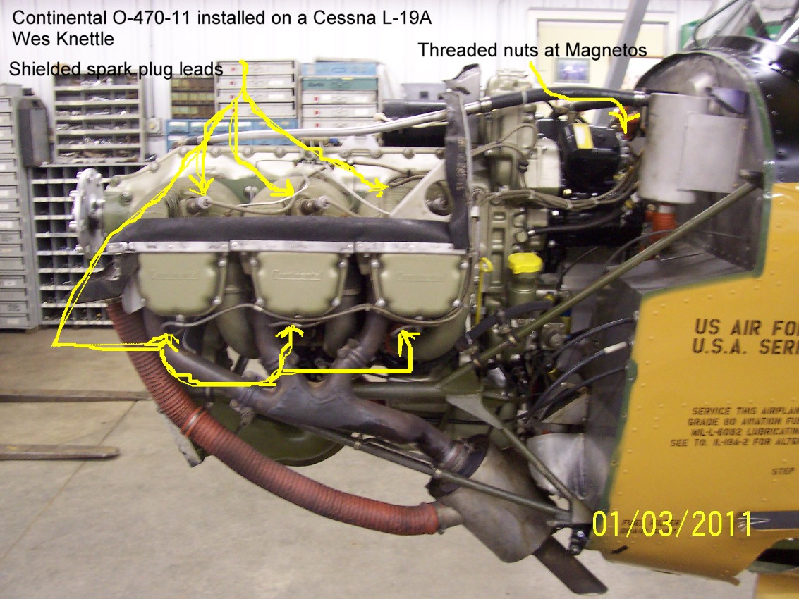

The aircraft modern shielded wire assemblies are quite serviceable. That is if you stay with the top shelf brands like the Slick and TCM harnesses. The older classics like the radials are even simpler to service and they are much closer in design to the tank and tactical vehicle ignition harnesses.
The real difficulty is with obtaining replacement parts. The aviation parts are plentiful and a wee bit more expensive than the automotive stuff but the older classic aircraft parts are generally larger thread sizes with the harness shield nuts since the aircraft use 18mm plugs for the most part and we are dealing with 14mm plugs. But a certian degree of mix and match can be done.
Jordan,
If you have a airport nearby stop there at an FBO (Fixed Base Operator) shop and talk with their lead mechanic or maintenance director.
The first two engines are 1940's engines and have very similar plug lead construction.
This is a 7 cylinder, 670 CI, 220 HP engine Produced during WWII. I installed this engine in 2000.
This is a 9 cylinder, 1340 CI, 600 HP engine produced during WWII. I installed this engine this past spring.
The engine below uses the modern shielded spark plug lead still produced today for piston engine aircraft. This is lighter, more compact and easier to assemble. This is a 6 cylinder, 470 CI, 215 HP engine produced in 1951. I just re-installed this engine two weeks ago.
