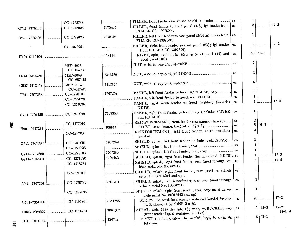

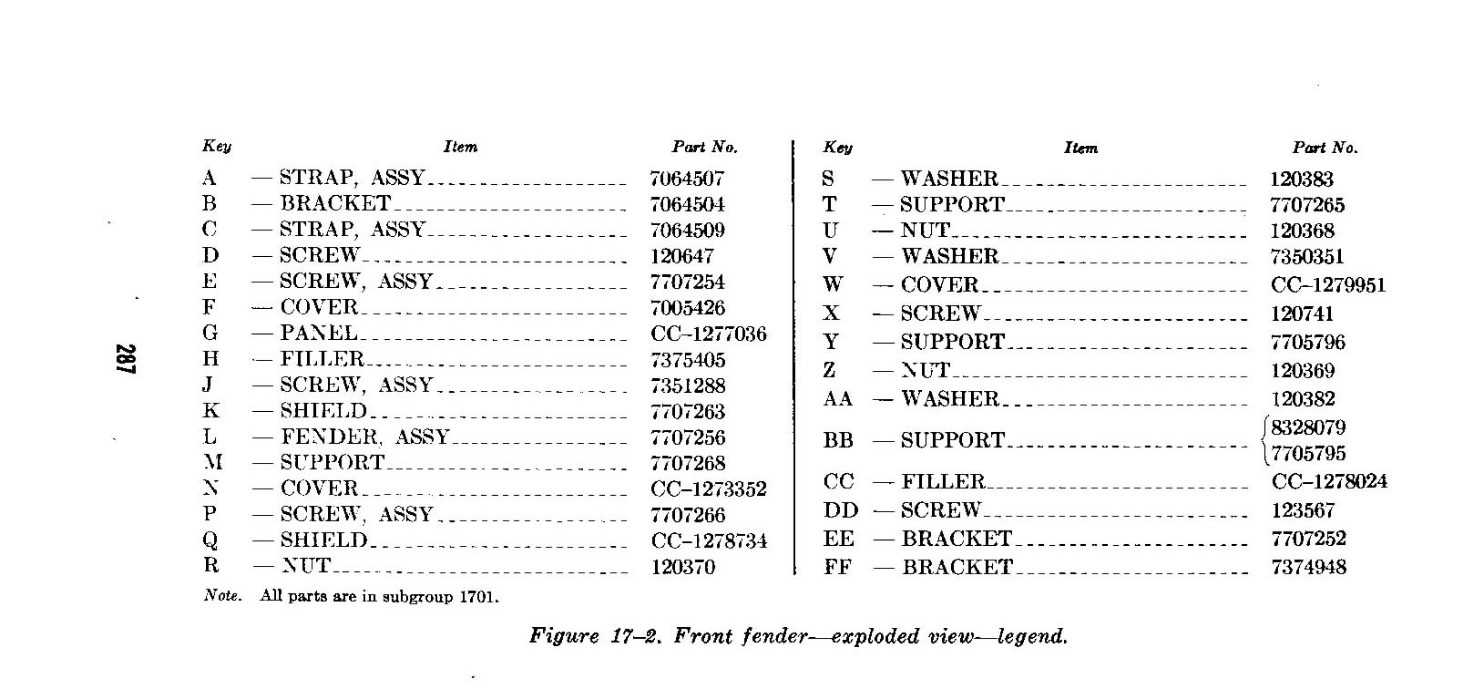

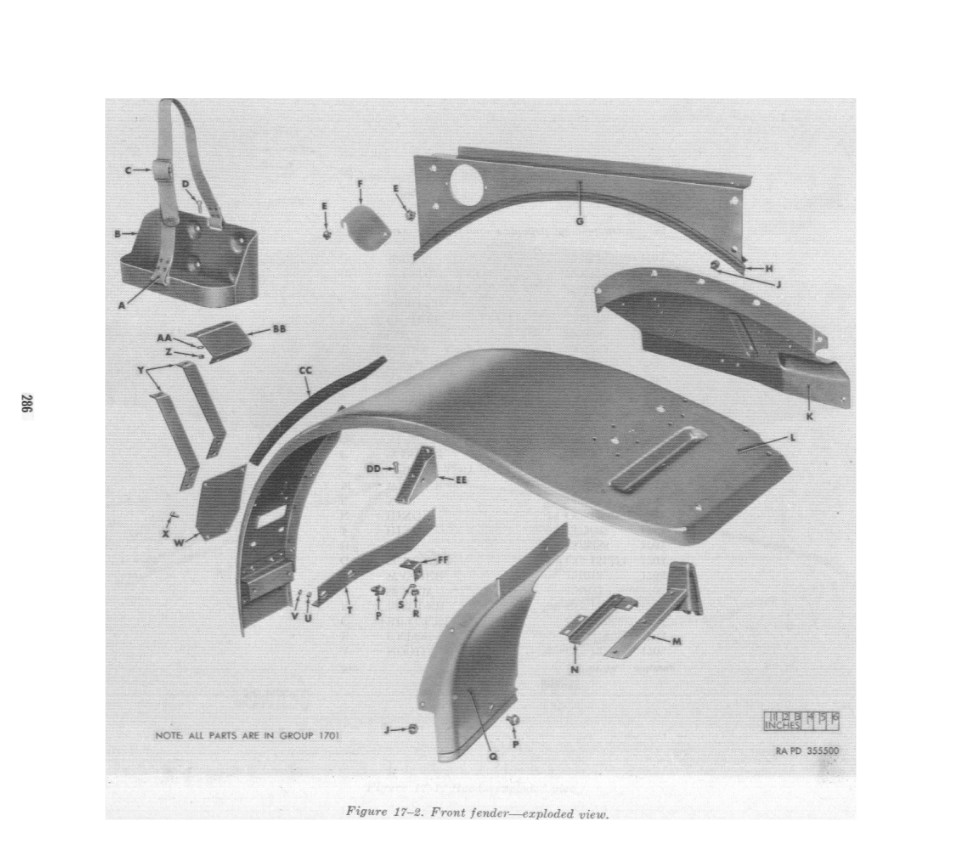

These are from the 54 ORD 9
286 Fig 17-2 Fender.JPG (122.58 KiB) Viewed 644 times
287 Fig 17-2.JPG (172.83 KiB) Viewed 644 times
289 Fender.JPG (211.14 KiB) Viewed 644 times
