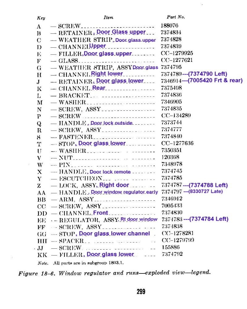

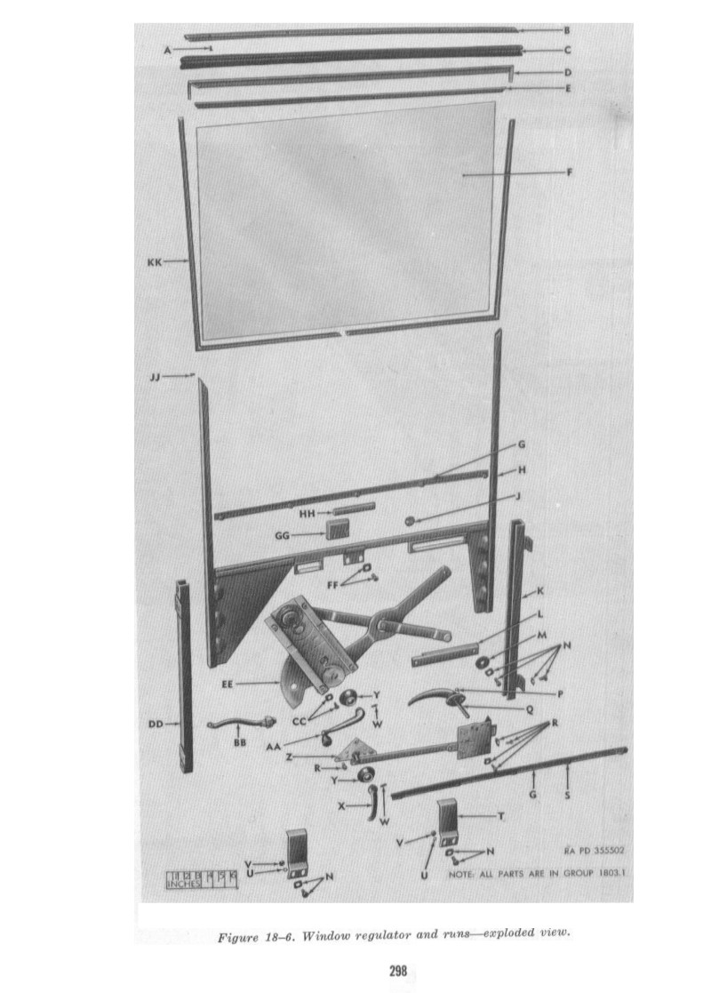

Re: Door glass and other door questions
At least on the Memphis site I saw the pieces instead of just a description.
The 54 ORD 9 has an excellent illustration and lists left and right separate parts and numbers.
Fig 18-6 Index sm.JPG (184.03 KiB) Viewed 1144 times
Fig 18-6 Door Window sm.JPG (144.46 KiB) Viewed 1144 times

Thanks Wes! DD, K are the two pieces I'm refering to. John
