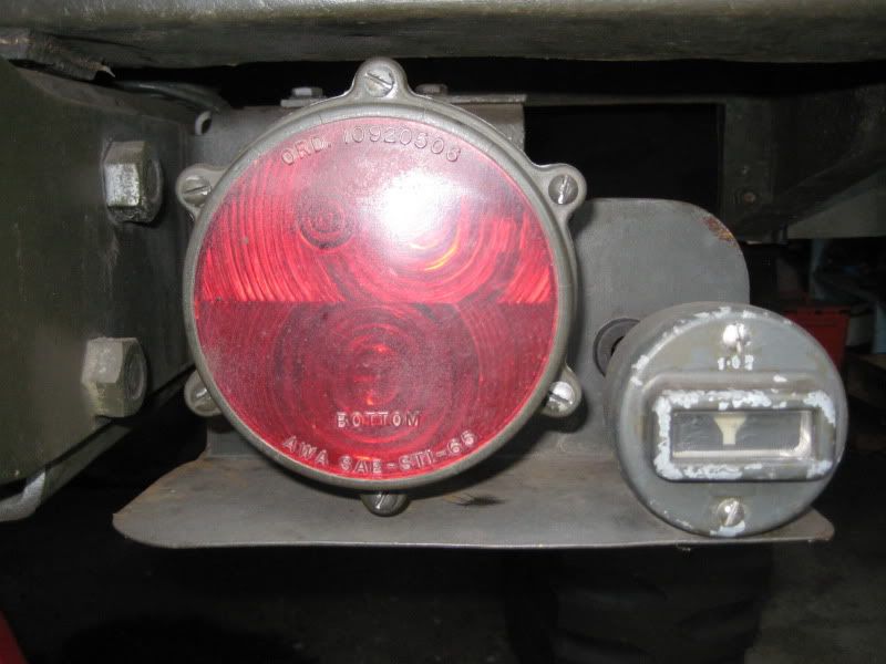

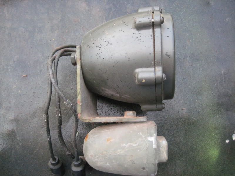

The one on my truck was made up by the Maryland National Guard DSGS unit I used to belong to for use when they were adding turn signals to early M37s, it's not stock but it works. The other is USGI for the right side of M37B1s, got this one with the parts buy I made recently.

Thanks for the pictures Carter they really help. but I think the B/O stop tail light has 2 cats eyes that are red.

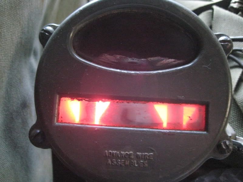

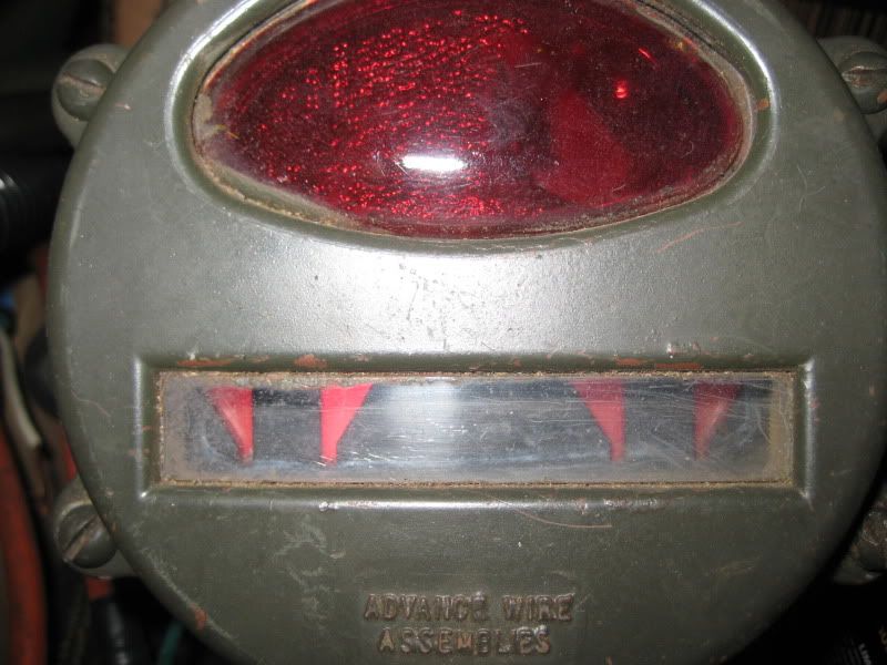

Looks like I was wrong again, what I showed was a blackout marker lamp and it's mounting bracket, the blackout stop lamp is in the same housing as the service drive tail and stop lamp.
BO stop light on

On the M37 on the drivers side you would have a brake/tail light lamp and the black out marker light (the four little red quotation marks). Then on the passinger side there would be a lamp housing like the the drivers side but the top lens would be a single quotation mark in white which is the black out stop light and the bottom would be the black out marker light (the four red marks). Now if there was a MWO (or maybe a unit directive) to put two tail/stop lights on the truck and move the black out stop to the bottom or side much like M151A1 were in the 60s then that is possible and the set up that Carter posted could be correct, though I've never seen those myself on a M37. I've either seen the original way or with the composite lamps which have the stop/tail light with the BO marker below that and the BO stop under that. I hope this helps the clear the confussion up a little.

M37B1s have left and right red lights for stop and turn signals and the BO marker lamp is then placed below the right light housing using the bracket shown older ones had them added because of an MWO to upgrade all early trucks lacking them.
The NG unit I was a member operated the state wide repair shop for all equipment and retrofitted signals to their and all other units early M37s. When my truck was run thru Letterkenny Ordnance Depot in the late 60s they added B1 wiring harness and signals but most of the components and nearly everything else was removed from the truck when a local govt. who had a doz. surplus Dodges stripped many items from several parts trucks to keep the fleet on the road.

Carter, I have never seen aspect like the one in the last pictures you posted with the red lower cats eyes (quotation marks) I have seen ones with a upper red lens and lower white quotation marks. I had composites on my truck when I got it but changed over to old style lights with gamma goat style tail light doors. The pictures you posted of the brackets is just what I needed.

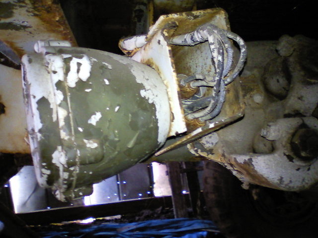

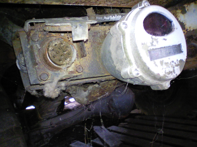

Sal, here are the pics. Let me know if you ndde any other angles.
