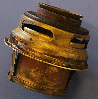

Should the thermostat be slightly open when cold or should it form a tight seal?
As you can see here my one is open a little bit.
Thanks
Stu

Here is a picture of a thermostat that I have sitting in the spare parts cabinet. Amb room temp was 72 degrees F. It is completely closed.

It is time to replace, that one is no good. Be sure you get a 180* replacement.

Charles, why should I get a 180 instead of a 165 that came off the truck?
Does it help warm up the engine quicker or is there more to it?
Thanks
Stu
MVT UK
SMVG Scotland
MSeriesRebuild
Posts: 2832
Location: Norwood, NC
Re: Thermostat setting
Post by MSeriesRebuild »
165* is too cold for an engine to run; does not burn off fuel by products sufficiently which will find their way into the oil causing early oil contamination. This simply creates issues that the additive package in the oil must deal with. Long story short, oil will become loaded with contaminents sooner drastically shortening its useful life. It has been well proven that the hotter an engine can run up to a point, the better .

MSeriesRebuild wrote:165* is too cold for an engine to run; does not burn off fuel by products sufficiently which will find their way into the oil causing early oil contamination. This simply creates issues that the additive package in the oil must deal with. Long story short, oil will become loaded with contaminants sooner drastically shortening its useful life. It has been well proven that the hotter an engine can run up to a point, the better .
Adding to what Charles wrote a another advantage is by using a hotter tstat the engine will actually NOT over heat as quickly due to the fact it slows the coolant flow and allows the radiator to function at it peak performance, if there were no or reduced restriction in the coolant flow as in taking out the tstat out of the system the coolant would flow through the radiator so quickly it would not have a chance to transfer the heat from the coolant and as you drive it just gets hotter and hotter until boil over occurs and always us a good coolant at a 50/50 mix.So as you see a the correct thermostat has many functions to keep a engine running properly.
