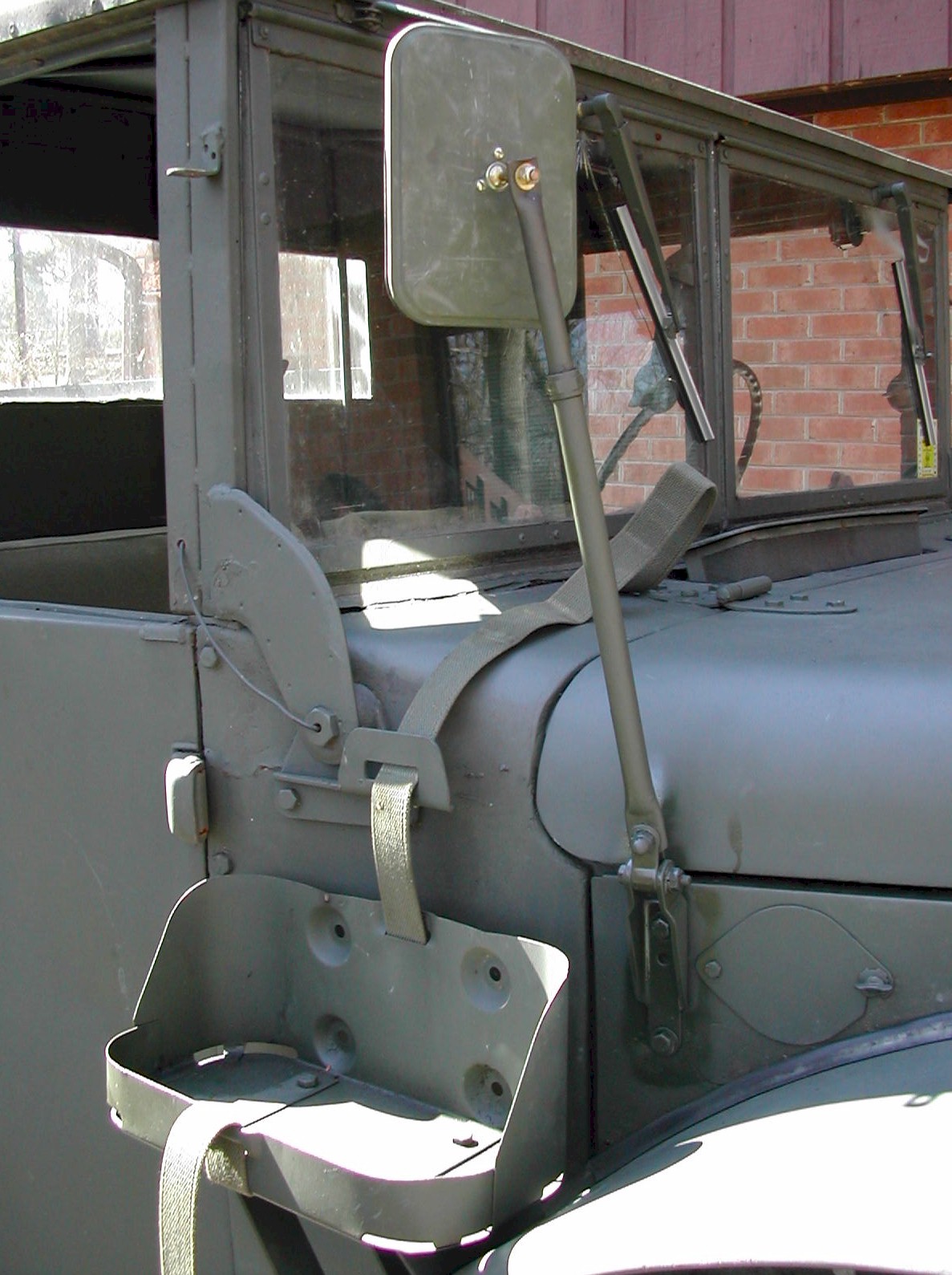

is there a strap guide for the fender mounted can?seems real wobly on there

There is a guide for the strap, you can see it in the photo that I took to show how my passenger side mirror is mounted...TOM R wrote:is there a strap guide for the fender mounted can?seems real wobly on there
The can can be wobbly if you your fender mounting bolts have worked loose as well...even though the jerry can bracket is tight itself, if the fender is a tad loose, it will look as if the can is shaking a lot when you dive down the road but the fender will be below your line of sight.
Larger version of the photo showing the stap is located at:
http://www.garbee.net/~cabell/december/ ... ntruck.jpg
