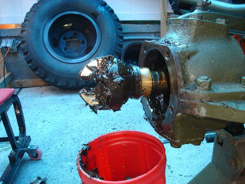

Out of necessity (both bushings/seals stuck, and no puller) I had to go the unorthodox route:
Drain front diff,
Pulled both axle shafts,
Pulled the center chunk,
Ran a length of tubing thru one side of the housing all the way across to the opposite seal/bushing...
...then a couple of raps with a hand sledge drove out the seal and bushing,
reverse the tubing then repeat the raps for the other side.
I have no measurements and already knew I was going with new bushings and seals from VPW.

When I replaced my bushings and seals they were so worn that when I pulled the axles the bushings came out with them. But I had to use a slide hammer to remove the seals. I wouldn't reuse the bushings...
