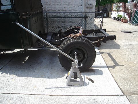

Re: Stuck Lug Nuts...
You might try this:
Using the Budd lug wrench and handle, get a cheater pipe, jack stand, and a sledge hammer. Put the lug wrench on, then the cheater pipe on the handle, then position the jack stand under the outer end of the lug wrench so the lug wrench remains purpendicular. Next, put your body weight on the cheater pipe (45 or 90 degrees on the handle) while your buddy hits the end of the lug wrench as you're forcing your weight downward. This often pops them loose.
Post by Sal »
Remember the nuts tighten went turned to the front, and loosen when turned to the rear of the truck... :?

8543bob
Posts: 318
Post by 8543bob »
HI SAL,
Did you get the nuts off with your gantry and lever??
BOB
