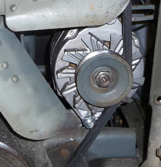

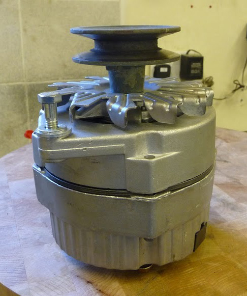

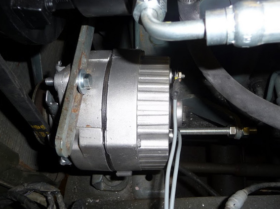

Wayne, I did the alternator upgrade and cant recommend it enough. Its a VERY simple wiring job and you can use the existing generator bracket. All you need is a long threaded rod to mount the unit on. You will also need
the pulley off your old generator. I had to have my old pulley lathed to make it fit as it was too deep for the alternator shaft.
If you go for the same type of alternator as mine you can expect it to start charging at very low revs, just over idle. Speak to Charles at M Series rebuild for the cost.

The harness you see on Ebay are for the military 60 amp system alternator. The M37UK photo is a one wire Delco unit (built in regulator) you can get for under $100 at any decent local automotive electric shop. Simple to wire in.
The military 60 and 100 amp alternators are nice looking upgrades but they are getting higher and higher every week. The 60 amp alternators are running over $250. The 100 amp alternators are much higher and a real PITA to install and maintain.
Just pull your generator and regulator and remove the pulley and take the pulley to your local auto-electric shop and tell them you want a 60 to 90 amp Delco indexed for left lower engine mounting that your pulley will fit on. I prefer the two or three wire Delcos so I can switch the power at the main switch. You'll have to dicker a bit with the mounting and the adjusting bracket.

Post by M37UK »
Wayne
I used 12mm threaded rod which is just under 1/2"
I mounted the alternator pivot in front of the existing bracket. Remember that my truck is Canadian so yours may be different if you have the US engine.
You only need 2 wires, one that grounds to the truck frame or engine block and the other which is connected to the starter motor positive terminal.
Thats it !
You will no longer need the original regulator, so it can be removed along with the associated wiring.
I cant remember how much was lathed off my pulley as I never did it myself.
Stu
