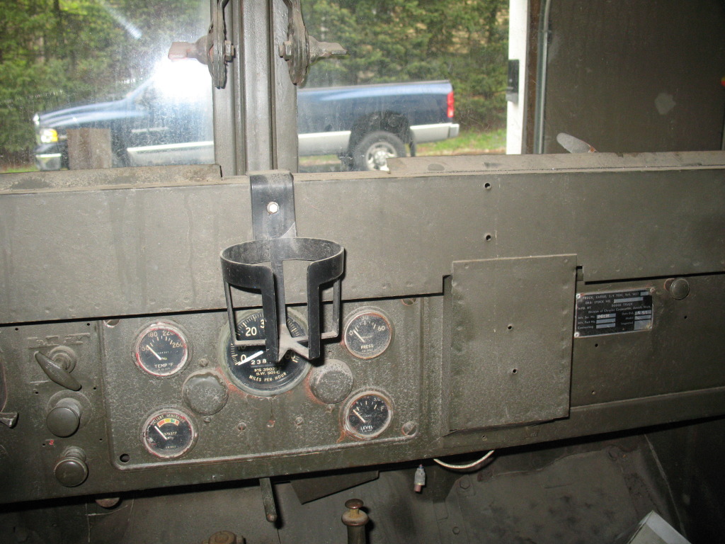

Gerry
Posts: 768
Location: Cheshire,Ct
Re: Defroster Tube
Post by Gerry »
Gerry
53 M37
Re: Defroster Tube
Gerry's defroster.jpg (235.44 KiB) Viewed 2519 times
Master Yota
Posts: 828
Re: Defroster Tube
Post by Master Yota »
Perhaps a dumb question, but how does one get to the window locks with the defrost tube on? Does it hinge downward at all? Or is there enough room to get hand between it and the window?
