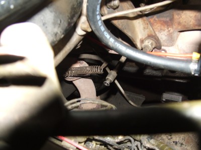

Hey Crew.
I think I have my fuel problem solved and now am on to the next problem/situation if you prefer! I found a 7/16" steel line with an inverted male flare fitting under the carburetor? There was a worm drive hose clamp hanging loose back on the line a ways?? Anybody know if this was some sort of a blow-by line?? I'll try and attach a shot of it. Thanks in advance!

Re: Mystery Line & Fitting???
Tim, is the line actually attached to the bottom of the carb or does it make its way over to the distributor?
I did not follow it around to the opposite side of the engine but I will. It is not attached to the carburetor! There is another fitting on the intake manifold that is plugged off, I'm wondering if there was some sort of a check vale for crankcase ventilation?
it looks like the line to the (missing?) PCV?
I've been doing a photo search of an engine rebuild and can't really find the picture I'm looking for. I do think it's some kind of a PVC valve line and the valve is missing??

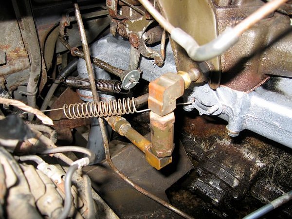

Tim, do you have any of the manuals?Tim Powell wrote:I've been doing a photo search of an engine rebuild and can't really find the picture I'm looking for. I do think it's some kind of a PVC valve line and the valve is missing??
1953 Dodge M43
Fail often to succeed sooner
- Tim Powell
- MSGT
- Posts: 827
I do not have any manuals yet! Yet being the key word! Thank you for the picture that is exactly the part/valve I'm missing!!
- The Mystery Part I'm Missing!! Thank You!
- Crankcase vent!.jpg (81.38 KiB) Viewed 1217 times
