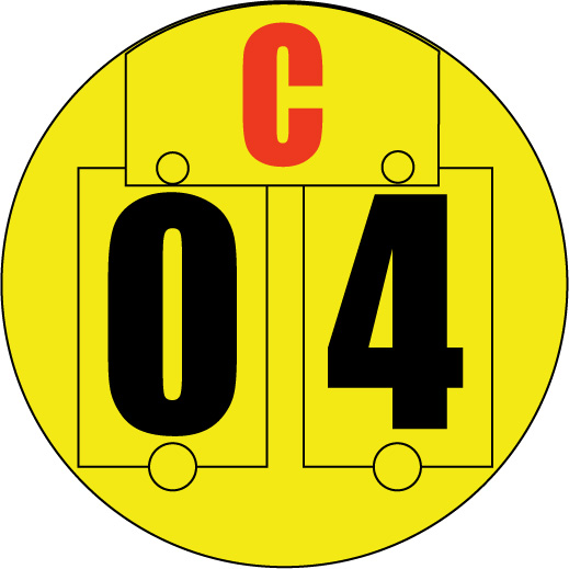

I have used what I think is appropriate and re-drawn it on the PC but maybe you guys can comment on it:
- bridge plate.eps.jpg (92.31 KiB) Viewed 1391 times
Stu

Re: Font
A block style font is also a family of fonts. This family was the prescribed type from 1940 thru the most of the 50's. M37's would have been block style and M37 B1's would probably have made the switch to the Gothic style.

Thanks Cuz, I think the last image you posted is the one I am looking for, with equalization of dimensions over the entire character.
The only thing I find odd about that font is the 7 has its top right corner cut away at an angle and the 7 that came with my plate doesnt. It must have changed at a later date as mine is a subdued green plate and numbers.
Thanks for your help everyone.
