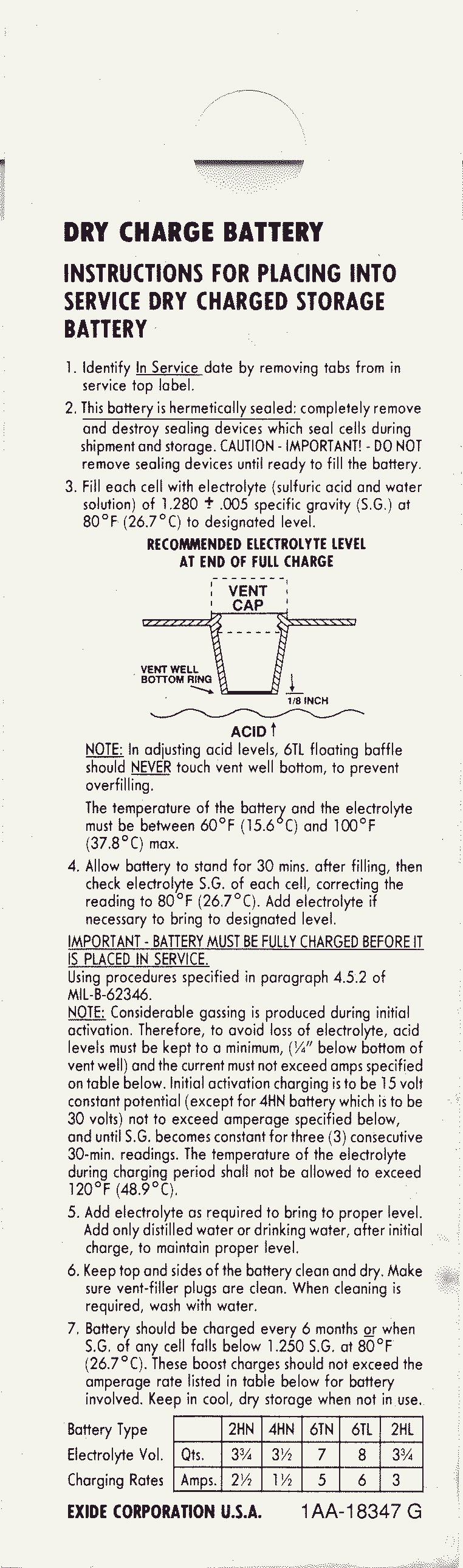

Re: New (old stock) batteries.
Battery and electrolyte should be at least 60 deg F or higher. Fill to just below the bottom ring in the filler port. Let the battery stand for an hour or so and then recheck fluid level. It should be at or just below the bottom ring. Check specific gravity with a battery hydrometer. The cells should all read 1.250 or higher. If any cell reads less then you need to charge the battery. There are a set of very detailed instructions from the battery manufacturer and the Army also published detailed instructions.

Posted this on the G503 and Steel Soldiers site for you also. Here is a scan of the instructions card that came with some NOS batteries I bought a couple years ago. This side is for dry batteries.
Dry battery.
Dry battery.
2HN Battery Instructions, 1.gif (62.31 KiB) Viewed 590 times
