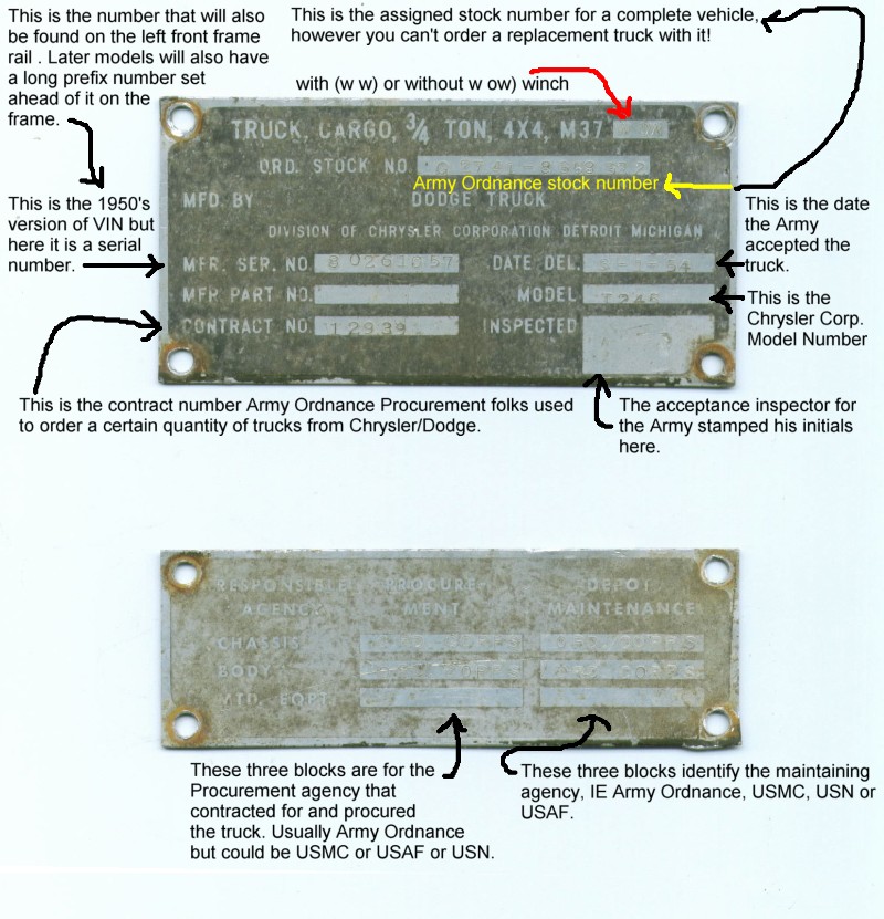

Hi and i would like to introduce myself as a very new owner of a 1951 M-37 yesterday.
name is Gordon and have done two other restorations 1952 pontiac and 1979 F-100

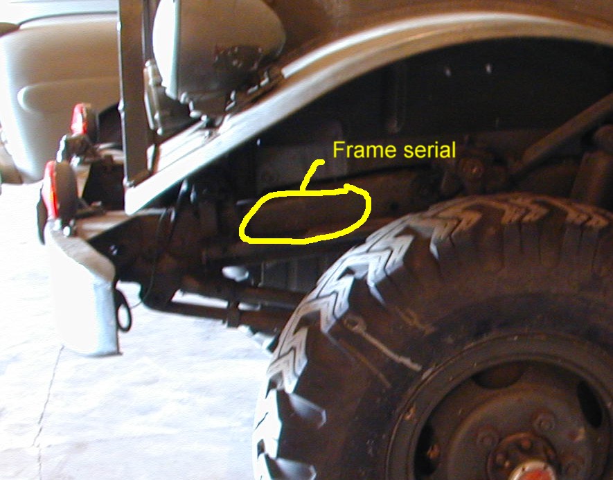

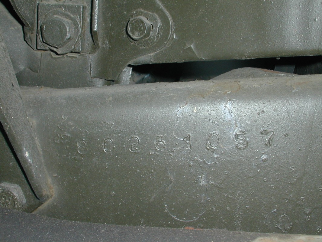

Question??? could someone show me or explain which numbers are which on the tag on the glove box. i am able to read the numbers but not their meaning and i was told that there is supose to be a vin on the frame. the location would be helpfull before i dismantle the vehicle. will be taking some pics before and during the restoration of this vehicle and expect it to be a two year project. thank you
Data plates 2 sm.JPG (174.96 KiB) Viewed 1608 times
Frame serial Loc.JPG (126.93 KiB) Viewed 1608 times
Frame serial.JPG (229.64 KiB) Viewed 1608 times
Later model trucks have a long numerical prefix as well.

Mr. Moderator,
Please make this post a stickee :!: :!: :!:
Its a question that is asked all the time and Wes has posted excellent pix :!: :!: :!:
