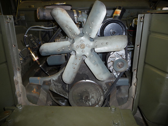

My Canadian does indeed have the 6 bladed fan also. I would guess that perhaps the blade angle is not as much as that on the 4 blade to compensate ?
Stu
6 blade fan.jpg (107.76 KiB) Viewed 888 times
